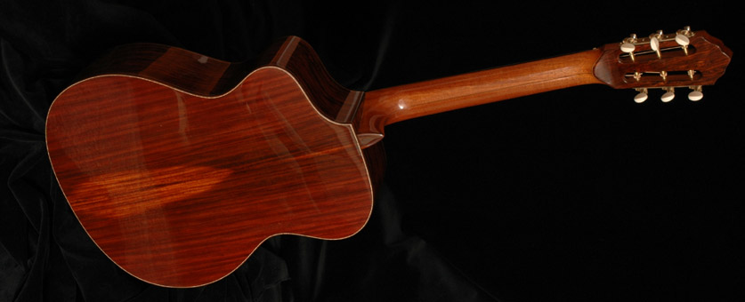

I just finished up a 4-5/8 or so deep body Cocobolo/40 year old cedar topped OM venetian .. it did not lack for bottom , mids, highs, sparkle, volume or sustain - it had it all in spades, and is one of the best guitars I have built. The top was floppy as all get out, and it ended up at about 140-145 thou in the rough, so maybe 135 finished .... some things just WORK. It had my regular symetrical X brace and sizings.
PostPosted: Tue Jun 12, 2007 8:07 am
Oh .. forgot .. it was a 13 fret 24.9 scale, wide 1-7/8 nut with a slotted headstock, 3 on a plate Waverlies, lower bout was 15 5/16. So maybe not technically an OM ... but I still call it one, curves came off a Martin ... thats really all I wanted, as that particular one sucked huge - it was awful, but stll useful for something - plagerism !!!!

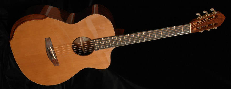

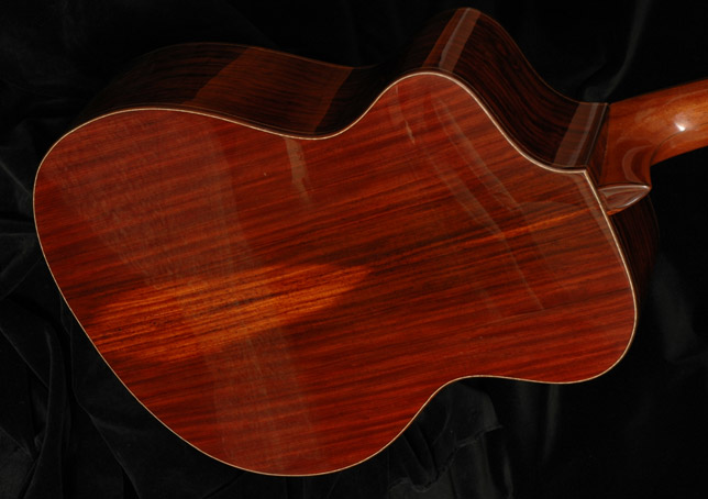

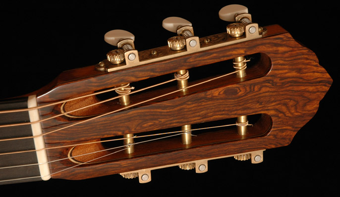

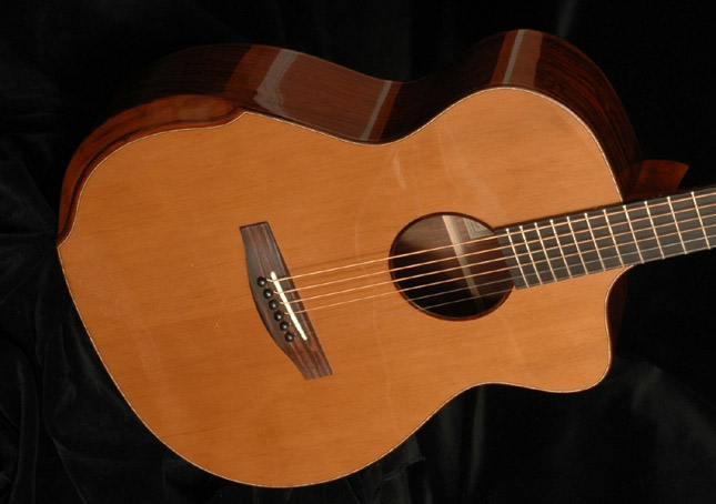

Just for you Hesh ....
Karol OM venetian, 40 year old cedar top, coco B&S, headplates, Braz bound soundhole and bridge, Laskin armrest.
PostPosted: Wed Jun 13, 2007 12:30 am
Wow! That's a beaut Tony!
